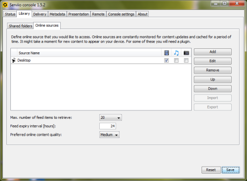

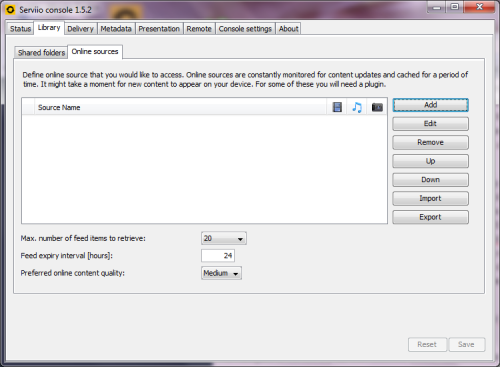

8. Navigate to the Library → Online Resources and click Add.

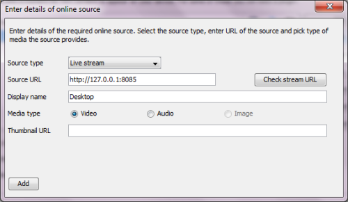

9. Fill the new window like this:
Source Type: Live Stream. Source URL: http://127.0.0.1:8085. Display name: Desktop (though you can choose any name you want). Then, click Add.
10. Click Save. This is very important.
